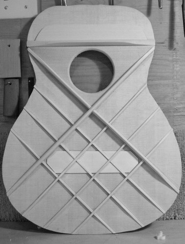

In comparison to others on this wonderful forum I am a complete neophyte but have built a couple of lattice braced instruments (both classical and steel string). I used spruce braces rather than the “Smallman” carbon sandwich and notched each course of brace to fit over the previous course. Think gluing the bridge plate down first then proceeding to fit the first course of braces over the plate and then the next course, and etc. It’s kind of hard to describe so I will include a picture of the top on my latest double aught.
I really like the clarity, projection, and balance that lattice braced instruments possess. People who have played my latest double aught have commented on the balance, note distinction, and incredible tone for such a small instrument. My goal was build a smallish guitar with out the “plunky” sound. I guess the top must have been cut at the right time of the month .
If I missed anything you were looking for in particular just let me know.
Cheers,
Jeremy

Do you have a pin bridge on this guitar and if so, do you just let the holes for the pins fall where they need to regardless of the braces running over the plane?
How thick did you make those lattice braces?

This guitar has my first incarnation of a pin less Pyramid Bridge and the bridge plate is spruce.
Rough lattice dimensions (height x width in mm):
“Bass” – 5 x 4
“Treble” – 7 x 4
In my very modest experience with building guitars I have come to disagree with the “thin tone, no warmth” generalization as this little guitar seems to have both in spades (but freak occurrences are possible I guess).
The guitar also has a relatively thick Sitka top (2.7 mm) and a shorter than average (635 mm) scale.
Cheers,
Jeremy
